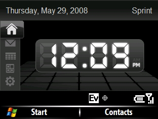

I think I can save you some time here
The LCD plugin works with an on, an off and a mask image (as you already figured out I guess).
The actual definitions are made within the *.ini file (name defined in homescreen xml).
It defines which colored parts of the mask file to display when a specific time occurs. 0-23 under [HORLOGE_PATTERN] are the hours, 26-85 are the minutes.
The definitions are made using the HEX code of the colors (see mask).
If you want to have 12-hour-format, you simply copy the HEX codes of 0-11 into the 12-23 definitions. The 26-85 patterns stay the same, as the minutes are the same in both 24- and 12-hour-format.

Thanks, Prosper. I figured out the image formats, etc. I had an idea that those numbers were for the time but couldn't figure out the sequence and how they worked until you explained it. Is the LCDPlugin SDK tool buggy? It somewhat helps out but I cannot get it to go past 10 minutes when editing the INI file in there. It's just weird. Now, there is an HTC Touch Homescreen that someone made (a really well made one) and it has AM / PM. Probably asking too many questions now that you've posted, but will the LCDPlugin detect automatically AM/ PM once I change it? And one final question, is it true that the alarm feature is within the LCDPlugin or does it go based off of the alarm within Windows Mobile? Read that it goes off of the plugin but I can't see where it is located.

Okay! I think I've figured out the AM/PM thing. Let's see if it works and I'll keep you guys updated.
It just clicked.
EDIT:
Still testing it to make sure it works and once done, will upload.

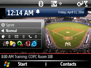

Here's the release of the GYP HTC Diamond with the LCD Plugin:
GYP HTC Diamond wLCD
Requirements:
Facade
LCDPlugin
Arial font (included)
Eko's Black Soft Keys
Additional Notes:
2 versions are included (standard MRU & Facade Launcher)
Thanks to Prosper and Rope for using the LCDPlugin in their homescreens which allowed me to study them for this homescreen. Credit given in XML file as well.

GYP Yankees wMRU
Will get to the others in time.
